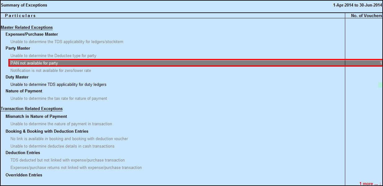

Summary of Exception - PAN not available for party
For correct Tax computation, its necessary that you specify the PAN number for all the Employees. The tax will be computed at higher rate if the PAN number for the Employee is not provided. You can check the information of Employees for whom the PAN is not provided from PAN Not Available screen.
     Go to Gateway of Tally > Display > Payroll Reports > Statutory Reports > Income Tax Reports > Exception Reports > PAN Not Available.

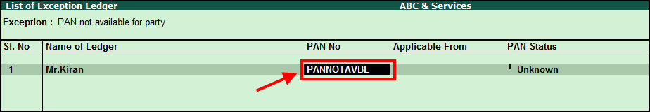

The above report displays the Employees for which PAN is not specified in the Employee Master screen.
     Specify the PAN for all such Employees in the Income Tax Number (PAN) field.
     Press Enter to accept and save.
