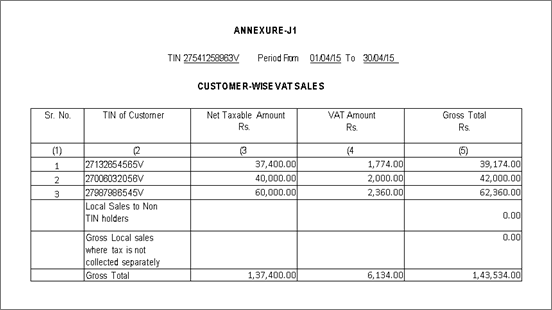

Annexure J1
Taxable sales with the following natures of transactions are displayed here.
     Sales Taxable
     Sales - Works Contract
     Sales - Lease
In e-VAT Annexures screen,
1.    Select Annexure J1 and press Enter.
2.    Click P:Print Annexure.
The print preview of Annexure J1 appears as shown below:
TIN
The VAT TIN entered in the Company Operations Alteration screen of F3: Statutory & Taxation features is displayed here.
Period - From and To
The period entered in From and To date fields in Print Report screen of Annexure J1 is displayed here.
Sr. No.
The serial number of transactions is displayed here.
TIN of Customer
The TIN/Sales Tax Number predefined for the party ledger master selected while invoicing taxable sales is displayed here.
Net Taxable Amount
The assessable value of taxable sales made within the State is captured party-wise in this column.
VAT Amount
The total output VAT on taxable sales is displayed party-wise in this column.
Gross Total
The total of assessable value and VAT amount is displayed here.
Local Sales to Non TIN Holders
The assessable value and output VAT of sales made to non-TIN holder (TIN is not predefined in the ledger master)by selecting output VAT ledger is displayed here.
Gross local sales where tax is not collected separately
The values of sales made to non-TIN holder (TIN not predefined in party ledger master) using VAT inclusive voucher class or without selecting output VAT ledger is displayed here.

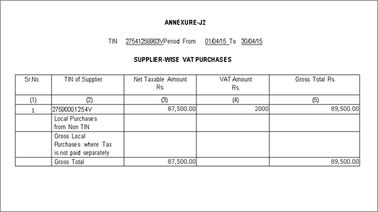

Annexure J2
Purchase transactions with the following nature of transactions are considered for this annexure:
     Purchase Taxable
     Purchase - Works Contract
     Purchase Taxable - Capital Goods
     Purchase From Unregistered Dealer
1.    Select Annexure J2 and press Enter.
The print preview of Annexure J2 appears as shown below:
TIN
The period entered in From and To date fields in Print Report screen of Annexure J2 is displayed here.
Sr. No.
TIN of Customer
The TIN/Sales Tax Number predefined for the party ledger master selected while invoicing taxable purchases is displayed here.
Net Taxable Amount
The assessable value of taxable purchases made within the State including purchase of capital goods is captured party-wise in this column.
VAT Amount
The total input VAT on taxable purchases is captured party-wise in this column.
Gross Total
Local Purchases from Non TIN Holders
The assessable value and input VAT of purchases made from non-TIN holder (TIN is not predefined in the ledger master)by selecting input VAT ledger is displayed here.
Gross Local Purchases where Tax is not paid separately
The values of purchases made from non-TIN holder (TIN not predefined in party ledger master) without selecting input VAT ledgers or by using VAT/Tax class - Purchases - From Unregistered Dealers is displayed here.
