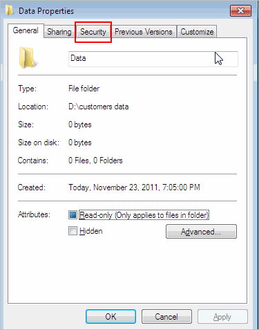

2.    Go to the location where Tally data is saved.
3.    Right click data folder > PropertiesSecurity.

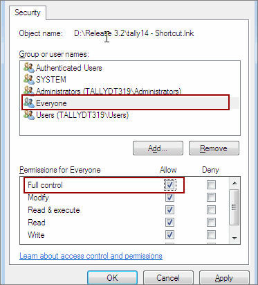

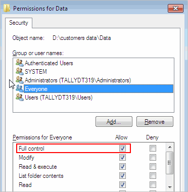

4.    Select Everyone and set the permission as Full control as shown below:
https://www.tallysolutions.com/tallyweb/projdata/temp/pss/crm/kb/KB_DWNLD_9275_20160518_0_Fig_2.gif

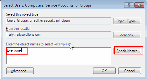

Note: If the option Group - Everyone is not available in the field Groups or user names, you can create the same. Click here to know more.
