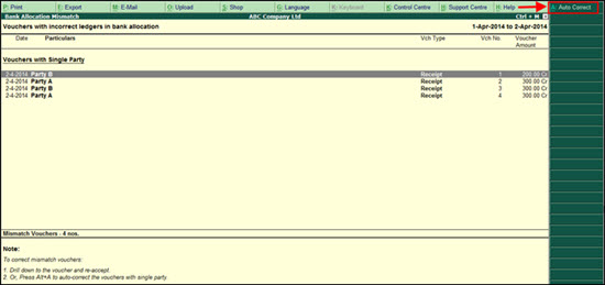

4. Press Enter to accept. The list of problematic vouchers appears as shown below:
5. Press Enter to drill down. The Bank Allocation Mismatch screen appears with list of voucher.
6. Click A: Auto Correct to reaccept all vouchers with correct ledgers in Bank Allocations screen.
Note: Alternatively, drill down to each voucher manually and reaccept with correct ledger in Bank Allocations screen.
