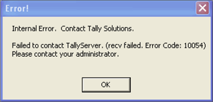

Failed to Contact TallyServer. (Recv Failed. Error Code: 10054)
The error message appears as shown below:
This error is caused by network connectivity issues.
Follow the steps mentioned below, in the server and client systems:
