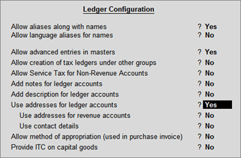

2.    Press F12: Configure to view the Ledger Configuration screen.
3.    Set the option Use addresses for ledger accounts? to Yes. The Ledger Configuration screen appears as shown below:
4.    Press Ctrl+A to accept.
Now you can enter the mailing details during ledger creation or alteration.
