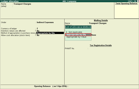

ABC Company wants to purchase stock items for cash and appropriate cost based on the quantity purchased. For this, ABC Company should enable the option Allow method of appropriation (used in purchase invoice)? in the F12: Configure of the ledger master, as shown below:
Under the option Method of appropriation in purchase invoice? in the ledger master, ABC Company can select Appropriate by Qty in the expense ledger as shown below:

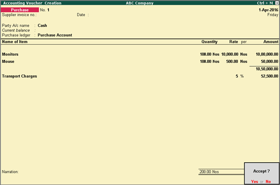

ABC Company then records a purchase voucher for stock items, with Transport Charges, based on quantity, as shown below:
Note: If a purchase ledger is not available already, press Alt+C in the Purchase ledger field to create one.
Since equal quantities of the stock items are purchased, the transport charges of Rs. 52,500 is appropriated at 1:1 ratio to each stock item. ABC Company has to calculate the ratio in the following manner:
Stock Item
Quantity of stock item * transport charges/total stock items = transport charges to be appropriated per stock item
Monitor
100 * 52,500/200 = 26,250
Mouse
Therefore, the transport charges of Rs. 52,500 will be divided equally and added to the values of the stock items. The total value of each stock item can be calculated in the following manner:
Stock Item
Amount + transport charges to be appropriated per stock item = total stock item value
Monitor
10,00,000 + 26,250 = 10,26,250
Mouse
50,000 + 26,250 = 76,250
ABC Company can verify the appropriation of cost based on the quantity of stock items purchased, in the Stock Summary report, as shown below:

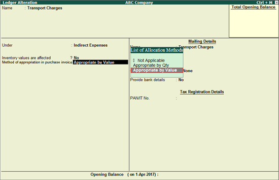

Similarly, for the same purchase voucher, ABC Company can also appropriate cost to stock items based on their value by selecting Appropriate by Value under the option Method of appropriation in purchase invoice? in the ledger master, as shown below:
Here, the transport charges (Rs. 52,500) is appropriated based on the stock item value. ABC Company has to calculate the ratio in the following manner:
Stock Item
Value * transport charges/combined value of stock items = transport charges to be appropriated per stock item
Monitor
10,000 * 52,500/(10,500) = 50,000
Mouse
500 * 52,500/(10,500) = 2500
Therefore, the transport charges (Rs. 52,500) will be divided in the ratio 1:20 and added to the values of the stock items in the following manner:
Stock Item
Monitor
10,00,000 + 50,000 = 10,50,000
Mouse
50,000 + 2,500 = 52,500
ABC Company can verify the appropriation of cost based on the stock item value, in the Stock Summary report, as shown below:
