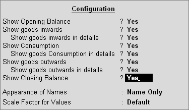

Configuring Material Consumption Summary
To configure the report
1.    Click F12: Configure.
2.    Enable the following options:
●     Show goods inwards
●     Show goods inwards in details
●     Show consumption
●     Show goods consumption in details
The detailed Material Consumption Summary will appear as shown below:
