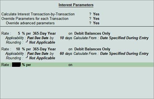

10.  Define multiple slabs with different rates and applicability.
The Interest Parameters screen with multiple slabs appears as shown below:
11.  Press Ctrl+A to accept the configuration.
12.  Press Ctrl+A to save the ledger.
In case of the above configuration, interest will be calculated at 5% starting from 10th day after due date and at 10% starting from 60th day after due date. Similarly, multiple slabs can be configured with different interest style, applicability, calculate from and rounding.

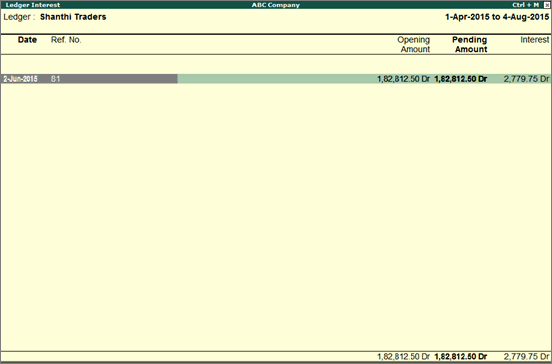

1.    Go to Gateway of Tally > Display > Statements of Accounts > Interest Calculations > Ledgers
2.    Select the required ledger. The Ledger Interest report appears as shown below:

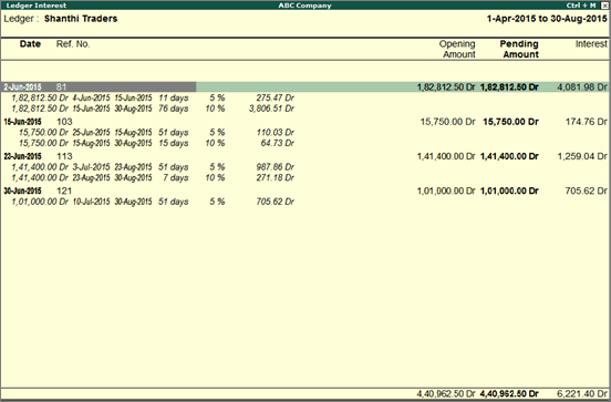

3.    Click F1: Detailed to view the calculation and period.
Note: In case if part of the amount is settled, the interest is calculated on the remaining balance.
