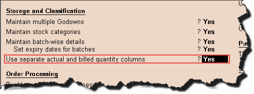

Set the option Use separate actual and billed quantity columns to Yes in F11: Features > F2:Inventory Features.

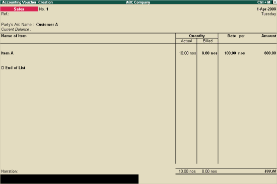

Purchase or Sales vouchers with Actual and Billed quantity will appear as shown.
In the screen shown above, there are two columns under Quantity:
●     Actual
●     Billed
Once when quantities are entered under Actual and Billed, stocks will be reduced to the extent of Actual quantities only.
For example, a company gives 2 items free as a sample to the customer, when 10 items are purchased. Then under Actual qty column 10 numbers will be entered and under Billed quantity 8 numbers will be entered. In the stock summary 10 numbers will be shown under Outwards.
