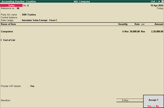

To record an interstate sales invoice against Form C
2.    Enter the reference number in Ref. field.
4.    Set the option Is Against C Form? to Yes in Party Details screen. This option appears only when the State selected is other than Tamil Nadu.
5.    Select the sales ledger predefined with the nature of transaction Interstate Sales Exempt - With Form C.
6.    Select the required stock items.
7.    Set the option Provide VAT Details? to Yes. In the Statutory Details screen,
o     Select C Form as the Form to receive.
o     Press Enter to save and return to sales invoice.
8.    Press Enter to save.
