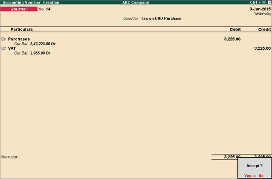

o Enter the Rate, Assessable Value, Commodity name, and Commodity Code of the item purchased in the VAT Details screen. The VAT Details screen appears as shown below:
o Press Enter to return to voucher screen.
The journal voucher appears as shown below:
5. Press Enter to save.
