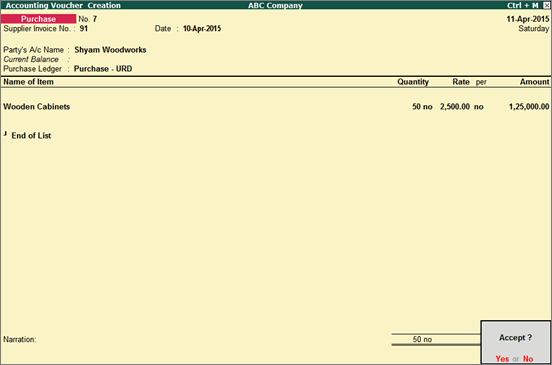

To record a purchase transaction from URDs
1. Go to Gateway of Tally > Accounting Vouchers > F9: Purchases.
2. Enter the Supplier Invoice No. and Date if any.
3. Select the supplier (unregistered dealer) ledger in Party’s A/c Name field.
4. Select the purchase ledger predefined with Purchase From Unregistered Dealer as the Nature of transaction.
5. Select the required stock items whose VAT rates are specified either at the stock group or stock item level. Enter Quantity and Rate for each stock item.
6. Press Enter to save.
