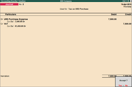

The journal voucher appears as shown below:
5.    Press Enter to save.
