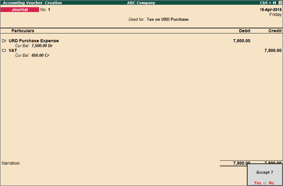

o Enter the Rate and Assessable Value of the item purchased, in the VAT Details screen. The VAT Details screen appears as shown below:
o Press Enter to return to voucher screen.
5. Enter Narration, if required.
The journal voucher appears as shown below:
6. Press Enter to save.
