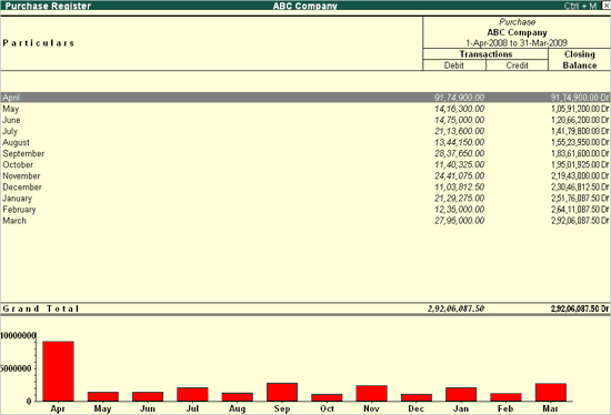

A Purchase Register displays the information on the periodic purchases of a business concern. Purchase register helps in analyzing the details of movement of purchased goods to various godowns, on the basis of which the stock movement at each godown is determined.
●     Go to Gateway of Tally > Display > Account books > Purchase  Register. The Purchase Register screen is displayed as shown below:
