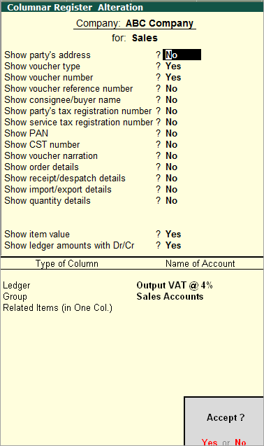

Tally.ERP  9  provides  you  the  capability  to  generate  columnar  reports  for  different  periods.  Select the  option  F5: Columnar  from the button bar, in the Sales Voucher Register screen.
The Columnar Register Alteration screen appear as shown below:
●     Type of Column: Select the Type of Column from the screen, as shown below:
●     All Items (automatic columns): If this option is selected, every ledger account will be displayed in a separate column.
●     All Item (in one col.): If this option is selected, all the ledger accounts are displayed in one single column.
●     Group: You can also select a group of ledger accounts to be displayed together in one column, e.g., Sales accounts. For other columns, you can use the additional options, namely Related accounts (automatic columns) or Related Items (in one col.).
●     Related Items (automatic columns or in one column): Related items indicates all the ledger accounts used in a voucher. Hence, the report will be similar  to  All  Items (automatic columns). This option is helpful when used in combination with a Group or a specific ledger account  in the first column.
●     Ledger: Select a specific ledger account e.g., VAT/Sales Tax. All other accounts can be put in one or more columns.

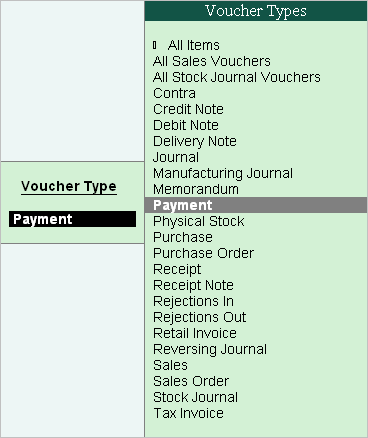

Change Voucher  Types
Use this button to view a different  register from within an existing  register . For example, if you are in Sales Register  and want to view the Payment register, press F4: Chg Vch and select Payment.
