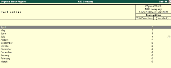

●     Go to Gateway of Tally > Display > Inventory Books > Physical Stock Register.
Physical stock register displays a list, showing the number of vouchers in each month.
