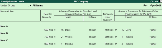

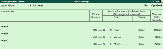

3.    Click R: Adv Reorder to view the Advanced Parameters for Reorder Level.
4.    Enter the Period (type the number and select the period as required).
5.    Select the Criteria, as required. The Specify Reorder Levels screen appears as shown below:
6.    Click M: Adv Min Qty to view the Advance Minimum Order Quantities.
7.    Enter the Period (type the number and select the period as required).
8.    Select the Criteria, as required. The Specify Reorder Levels screen appears as shown below:
9.    Press Enter.
10.  Specify the advanced parameters for all stock items, if required.
11.  Press Enter.
12.  Press Enter to save.
