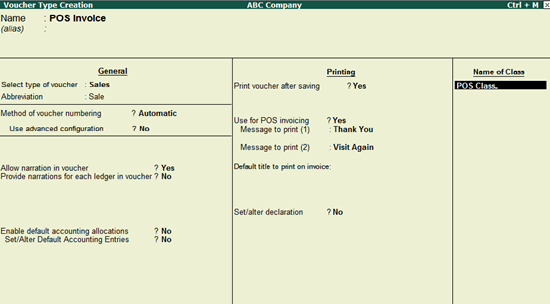

To create POS Voucher Type with Voucher Class
1. Go to Gateway of Tally > Accounts Info > Voucher Type > Create.
2. Enter POS Invoice as the Name.
3. Set Sales as the Type of Voucher.
4. Set the Method of Voucher Numbering as Automatic.
5. Set Use for POS Invoicing? to Yes.
Note: The Use for POS Invoicing? option will appear only when the Default Tax Unit is set to Not Applicable.
6. Enter Print Message 1 and Print Message 2, as required. You can enter any custom messages (such as "Thank You" or "Visit Again"), which will be printed at the bottom of the POS invoice.
7. Enter the Default Print Title, as required.
8. Enable Set/alter declaration, if required.
9. Enter the Name of Class. The Voucher Type screen appears as shown below:
10. Enable Gift Vouchers, Credit/Debit Card Payment, Cheque/DD, Cash as required and select the corresponding ledgers.
