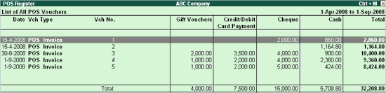

POS Register lists all transactions made over a particular day and by default displays the last invoice entry date of a POS invoice. Each POS Invoice is further drilled down to obtain the lowest level of information.
To view the POS Register
1.    Go to Gateway of Tally > Display > Accounts Books > POS Register. The POS Register appears as shown below:

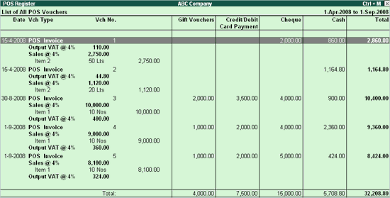

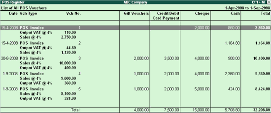

2.    Click F1: Detailed to view the report in detailed mode.  The POS Register appears as shown below:

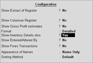

3.    Click F12: Configure to configure the report.
4.    Set Show Inventory Details also to Yes and view the List of All POS Vouchers with Inventory details.
