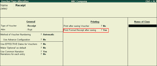

To activate Formal Receipt in Tally.ERP 9,
1. Go to Gateway of Tally > Accounts Info > Voucher Types > Alter.
2. Select the voucher type Receipt.
3. Set the option Print Formal Receipt after saving to Yes.
4. Click Accept to save.

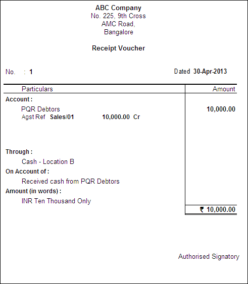

To print the receipt voucher,
2. Select Receipt as the voucher type.
3. Set the option Print after saving voucher to Yes.
4. Enter a receipt voucher and Tally.ERP 9 will prompt to print the Formal Receipt (to be issued) and the receipt voucher (for the company's records).
5. In F12: Configure, Receipt Printing Configuration, set the options Print Bank Details and Print All Details to Yes.
The receipt voucher for the same information when printed, appears as shown below:
Note: The information required can be configured under F12: Configure after giving the Print command.
On enabling the option Print Bank Transaction Details in F12:Configure, the bank details will be captured in the receipt voucher as shown below:
