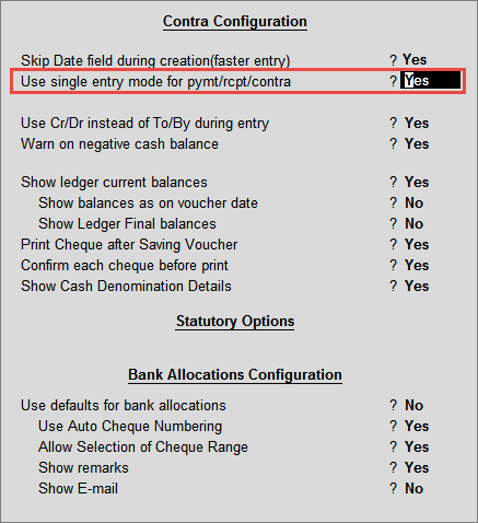

The Contra Voucher can be recorded using Single entry mode or Double Entry mode.  To toggle between Single Entry and Double Entry mode, we need to change the setting Use Single Entry mode for Pymt/Rcpt/Contra to Yes/No in F12: Configure.
Refer to F12: Configuration in Tally.ERP 9 for more details.

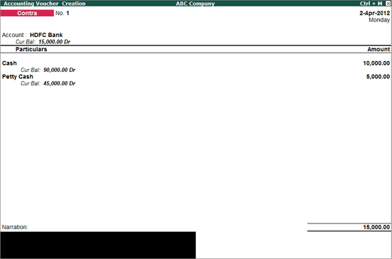

To view Contra Voucher creation screen in Single Entry mode,
1.     Go to Gateway of Tally > Accounting Vouchers > Select F4: Contra
2.     For example, to transfer funds from Cash Account to Bank Account:
●      Debit the Bank Account.
●      Credit the Cash Account.
The entry will be displayed as shown:
