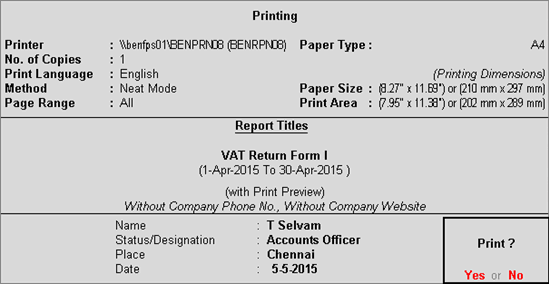

To print Form I
1. Go to Gateway of Tally > Display > Statutory Reports > VAT > VAT Form I > VAT Form I
2. Press Ctrl+P to print the form.
3. Enter the Name, Status/Designation of the authorised person, Place and Date.
4. Press Enter to generate the print preview of Form I as shown below:

DECLARATION |
The Place, Date, Name of Authorised Person and Status/Designation is captured as per the information provided in Print Report screen of Form I. |
