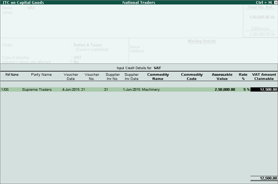

7.     Enter the references of tax credit in ITC on Capital Goods screen.
The ITC on Capital Goods screen appears as shown below:
8.     Press Ctrl+A to save and return to the Ledger Creation screen.
