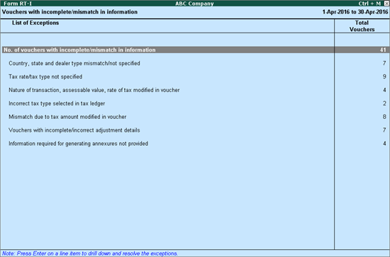

Summary of Exceptions
Vouchers with incomplete/mismatch in information list includes voucher that contain VAT or CST related information but are not included in the count of Included in returns/annexures and Not relevant for returns/annexures.
You can identify the exceptions and correct the transactions before filing tax returns. Based on the state selected the VAT report appears. The Vouchers with incomplete/mismatch in information report for Form RT-I of Bihar appears as shown below:
The exceptions are listed in the order of priority, based on the importance of the information for generating returns and annexures. Hence, a voucher with multiple exceptions is listed in the exception type higher up the order. Once that exception is resolved, the voucher will move down to the next exception type. Such vouchers with multiple exceptions continue to be listed as exceptions until all incomplete/mismatch information is resolved. This will help you clear all exceptions before filing the returns.
However, vouchers with only one exception are moved to Included in returns/annexures list after that exception is resolved.
No. of voucher with incomplete/mismatch in information
Displays the count of total vouchers with exceptions. Drill down from this row to view all the vouchers with exceptions, number of exceptions in each voucher, and type of exception.
To resolve all exceptions without having to go from one exception type to another
1.     Select No. of voucher with incomplete/mismatch in information.
2.     Press Enter to display Exception Resolution screen with the list of vouchers, number of exceptions in each voucher, and exception types. The Exception Resolution screen appears as shown below:
3.     Select any transaction and press Enter to display the Voucher Details Alteration screen which is divided into multiple sections, one for each exception in the voucher, as shown below:
Note: Based on the state specific TIN code, the first two digits are prompted in the message displayed under Validation Rules.
4.     Select or enter required information for the first exception type. Further, you can click F5: Recompute or A: Accept as is to recompute or accept the details, respectively.
5.     Press Enter to navigate to next exception type.
6.     Resolve the exceptions by providing details or using the buttons provided.
7.     Press Enter after all exceptions in the voucher are resolved to view the next voucher with respective exceptions.
8.     Continue resolving the exceptions voucher by voucher, or press Esc to return to Exception Resolution screen.

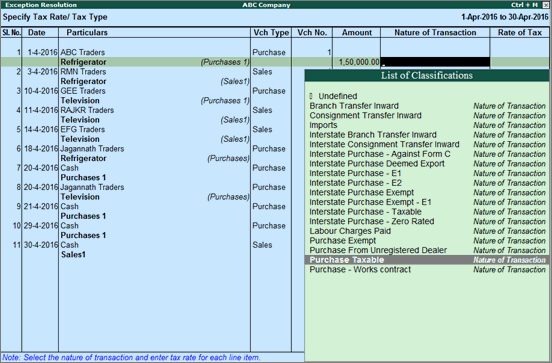

Tax rate/tax type not specified
Displays the count of transactions for which the rate or tax type is not selected in the item/ledger master.
To resolve this exception
1.     Select the exception Tax rate/tax type not specified.
2.     Press Enter. All the transactions of the exception type are displayed. The Exception Resolution screen appears as shown below:
Note: Based on the state specific tax structure, the columns are displayed. The column Addl. Tax Rate appears for Gujarat and Uttar Pradesh.
3.     Select the Nature of transaction, if not provided.
4.     Enter Rate of Tax, as required for each transaction.
5.     Press Enter to save.
Note: Click X: Exclude Vouchers to exclude the voucher from forms and annexures.
