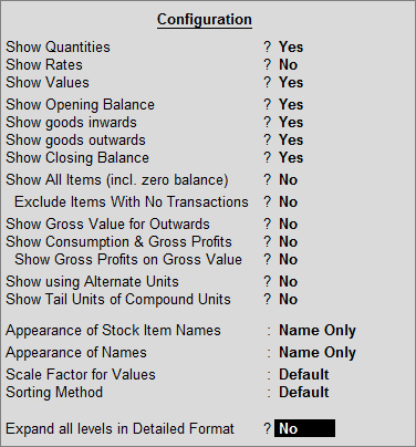

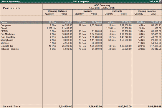

To configure the Stock Summary statement to display the flow of goods
●      Select F12: Configure while on the Stock Summary screen.
The Stock Summary displays the flow of stock, that is, opening stock, goods inwards, goods outward, and closing stock.
The Stock Summary appears as shown below:
The report is quantitatively reconciled, that is, Opening quantity + Inward Quantity – Outward Quantity = Closing Stock Quantity. However, this is incorrect for the values as the outward value displays sale values, not cost. The closing stock value is, however, based on cost and the cost method adopted for each item. Value reconciliation is possible if you are using consumption figures instead of sales values.

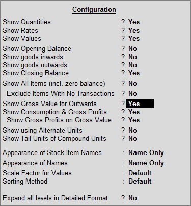

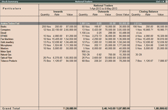

To view gross value for outwards in Stock Summary
1.     Select F7: Show Profits or F12: Configure while on the Stock Summary screen.
2.     Set the option Show Gross Value for Outwards  to Yes.
The Stock Summary report is displayed as shown.
Note: The Gross Value that appears is inclusive of the value of VAT/any other allowed ledgers that were chosen during the sales of the item.

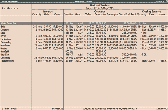

To view the consumption and gross profits
2.     Set the option Show Consumption and Gross Profits to Yes. The Stock Summary report appears as shown below:
Note: The gross profit is calculated on the gross value, which is inclusive of the values of VAT/allowed ledger under accounting allocation screen of the stock item.

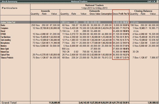

To show the gross profit on the gross value.
●      In F12: Configure, set the option Show Gross Profits on Gross Value to Yes.
The Outwards column shows Consumption, Gross Profit value, and Perc (percentage). The gross profit and percentage values are different from the previous values, as they are calculated on gross value.
