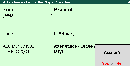

To record positive attendance type
1.     Go to Gateway of Tally > Payroll Info. > Attendance/Production Types > Create.
2.     Enter the Name of the attendance type.
3.     Select Primary from the list for the field Under.
4.     Select the Attendance type as Attendance/Leave with Pay. The Period type appears automatically.
5.     Press Enter to save.
Note: You can also create the Attendance Type Absent as Leave without Pay for recording negative attendance in the same manner.
