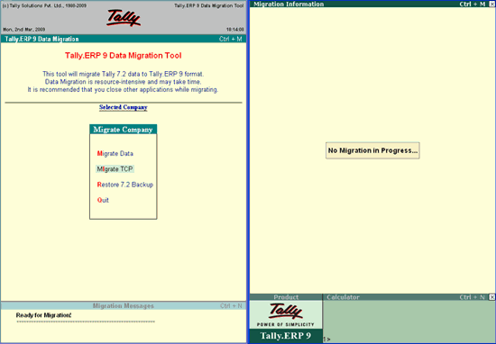

To migrate TCP files from Tally 7.2 to Tally.ERP 9
1.     Click Migrate TCP from Tally.ERP 9 Data Migration screen.

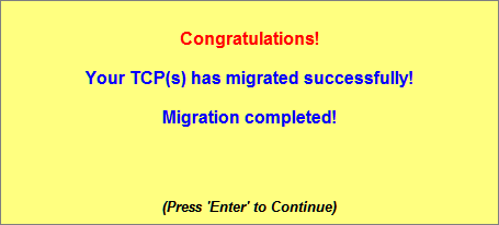

2.     Select Yes to continue in the confirmation message Migrate TCP(s)? Yes or No. On migrating the TCP file from Tally 7.2 to Tally.ERP 9, a congratulatory message is displayed as shown below:
3.     Press Enter to continue.
