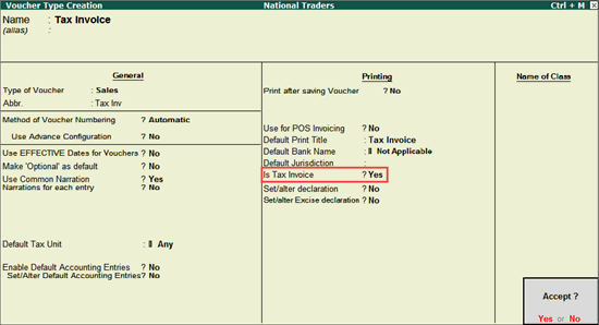

To create a tax invoice voucher type
1.     Go to Gateway of Tally > Accounts Info. > Voucher Types > Create.
2.     Enter the Name of the voucher type.
3.     Select Sales as the Type of Voucher.
4.     Enter the abbreviation, as required.
5.     Set the Method of Voucher Numbering? to Automatic.
6.     Enter Tax Invoice as the Default Print Title.
7.     Set the option Is Tax Invoice? to Yes.
The Voucher Type Creation screen appears as shown below:
8.     Press Enter to save.
