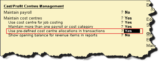

1.     Go to Gateway of Tally > F11: Features >  F1: Accounting Features. Set the option Use pre-defined cost centre allocations in transactions to Yes.
(The other options can remain as previously set and are not discussed here.)

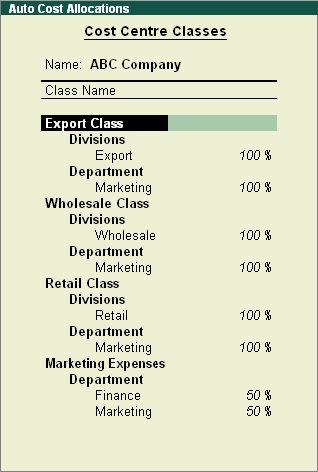

2.     Click Enter, which will pop up Auto Cost Allocations-Cost Centre Classes creation screen. Type the Class name and select the Categories and the respective cost centres. Specify the percentage of allocation. After entry, your auto-cost allocation screen will be displayed as shown:
You have created the Cost Centre Classes as Export, Wholesale, Retail and Marketing Expenses. Divisions and Departments are cost categories. Export, Wholesale and Retail are cost centres under Divisions. Marketing and Finance are cost centres under Departments.
It is not necessary to have the same names for the classes and the cost centres, as shown in the above example.
