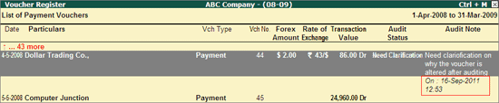

o      Move the cursor to the Total Vouchers column for the required Voucher Type and press Enter.
The above report displays all the Vouchers for the selected Voucher Type along with the other details such as Voucher No., Forex Amount and Rate of Exchange for the Forex Vouchers, Transaction value, Audit Status and Audit Note.

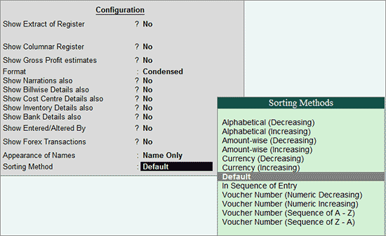

F12: Configure
Click on F12: Configure or press on F12 to alter the default display for the above report.
●      Show Narrations also: Set this option to Yes to display the Narration entered by the Client during the Voucher entry.
●      Show Billwise Details also: Set this option to Yes to display the bill details entered during the voucher entry.
●      Show Audit Status: Set this option to Yes to display the Audit Status as selected by the Auditor during the Audit. This option is set to Yes by default.
●      Show Audit Note: Set this option to Yes to display the Audit Note as entered by the Auditor during the Audit. This option is set to Yes by default.
●      Show Client's Clarification: Set this option to Yes to display the Clarification Note entered by the Client for the Vouchers marked as Need Clarification by the Auditor.
●      Show Date and Time: Set this option to Yes to view the Audit Date and Time.
●      Sorting Methods: Using the sorting methods available, vouchers can be sorted in reports based on:
o      the voucher number (alphabetic) either in ascending or descending order.
o      the voucher number (numeric) either in ascending or descending order.
This sorting will work even if alphabets are prefixed using advanced configuration provided for automatic numbering in the voucher type master.
The Voucher Register is displayed as shown:
Show Vouchers of Audit Status: Select the required Audit Status for Vouchers (from Altered, Audited, Clarified, Need Clarification, Unaudited, Under Observation, On Hold and Any) to filter and display the Vouchers for the selected Audit Status.
●      Show Vouchers Having Currency: Select the required Currency to filter and display the vouchers for the selected currency.
●      Sorting Method: Select the appropriate method from the list of sorting methods.
