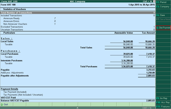

After all the required changes including adjustments and payments are made, it is required to save the report before generating and printing the returns.
To save the report

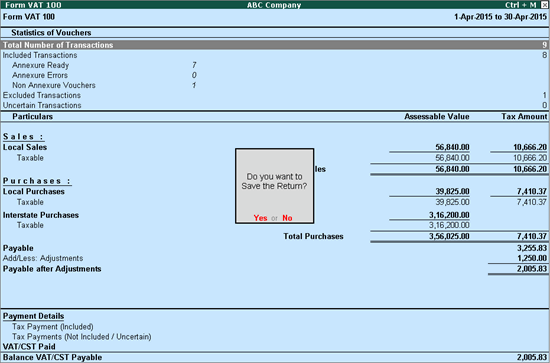

1.     Press F6: Save.
2.     Click Yes in Do you want to Save the Return message.

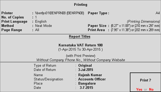

3.     Press Ctrl+P (Print Form button) and provide the relevant details in the Printing screen
4.     Press Enter to print.
