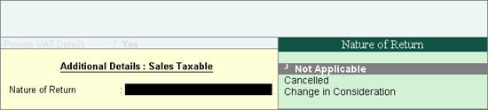

9.     Set the option Provide VAT Details to Yes, and select the Nature of Return as shown below:
Select Not Applicable for sales returns. for cancellation of sales or change in consideration, select the relevant Nature of Return.
