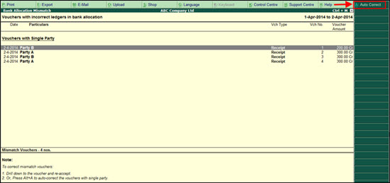

4.     Press Enter to accept. The list of problematic vouchers appears as shown below:
5.     Press Enter to drill down. The Bank Allocation Mismatch screen appears with list of voucher.
6.     Click A: Auto Correct to reaccept all vouchers with correct ledgers in Bank Allocations screen.
Note: Alternatively, drill down to each voucher manually and reaccept with correct ledger in Bank Allocations screen.
