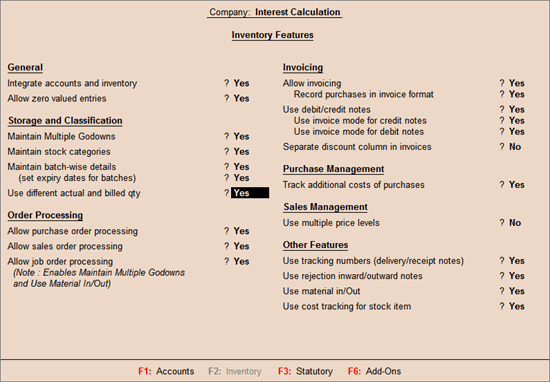

Recording of Actual Quanties and the Billed Quanties are essential to get the accurate stock values and sale/purchase value i.e., the Books of Accounts should be updated with the Billed quantities and Stocks has to be updated only with the Actual Quantities. Tally.ERP 9 allows you to record both these in different fields i.e., Billed and Actual Quantity separately in the same invoice.
Note: The Actual Quantity updates stock and the Billed Quantity affects the accounts and thus shows the correct position of both Accounts as well as Inventory.
Set the option Use different Actual and Billed Qty to Yes in F11:Features:F2:Inventory Features.

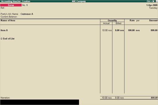

Purchase or Sales vouchers with Actual and Billed quantity will appear as shown.
In the screen shown above, there are two columns under Quantity:
Actual
Billed
Once when quantities are entered under Actual and Billed, stocks will be reduced to the extent of Actual quantities only.
Example:
A company gives 2 items free as a sample to the customer, when 10 items are purchased. Then under Actual qty column 10 numbers will be entered and under Billed quantity 8 numbers will be entered. In the stock summary 10 numbers will be shown under Outwards.
