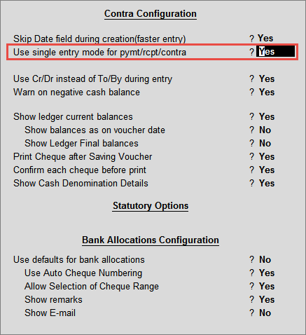

The Contra Voucher can be recorded using Single entry mode or Double Entry mode. To toggle between Single Entry and Double Entry mode, we need to change the setting Use Single Entry mode for Pymt/Rcpt/Contra to Yes/No in F12: Configure.
Refer to F12: Configuration in Tally.ERP 9 for more details.
