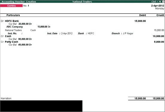

The Contra voucher can be recorded using Double Entry mode where we have the option to select multiple Debits and multiple Credits. To select multiple Debit and Credit ledgers in the Double entry mode, set Use Single Entry Mode for Payment/Receipt/Contra to No in F12: Configure.
Refer to F12: Configuration in Tally.ERP 9 for more details.
Go to Gateway of Tally > Accounting Vouchers
Select F4: Contra from the Button Bar or press F4.
If you record the same entry (passed in single entry mode) in Double Entry Mode, it will be displayed as shown:
