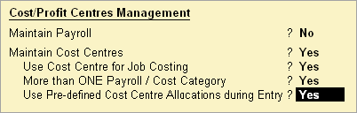

Go to Gateway of Tally > select F11: F1: Accounting Features
Set Use Pre-defined Cost Centre Allocations during Entry to Yes
(The other options can remain as previously set and are not discussed here.)

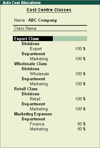

Click on Enter, which will pop up Auto Cost Allocations-Cost Centre Classes creation screen. Type the Class name and select the Categories and the respective cost centres. Specify the percentage of allocation. After entry, your auto-cost allocation screen will be displayed as shown:
You have created the Cost Centre Classes as Export, Wholesale, Retail and Marketing Expenses. Divisions and Departments are cost categories. Export, Wholesale and Retail are cost centres under Divisions. Marketing and Finance are cost centres under Departments.
