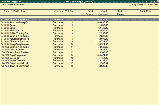

Go to Gateway of Tally > Audit & Compliance > Audit & Analysis > Verification of Vouchers
Select the required Voucher Type and press Enter
Select the required Month from Voucher Monthly Register and press Enter

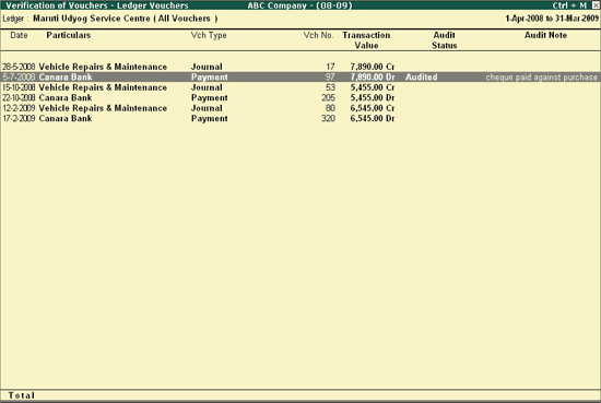

Go to Gateway of Tally > Audit & Compliance > Audit & Analysis > Verification of Vouchers > Click on Ctrl+V: Group/Ledger wise
Select the required Group and press Enter
Select the required Subgroup (if any) and press Enter
Select the required Ledger and press Enter
Note: To view the Ledger Vouchers report, the Auditor can press Enter on the Ledger name if displayed at the Verification of Vouchers report itself ( in case if the Ledgers are directly created under the Primary Group).
The Ledger Vouchers report displays the transaction details such as Voucher Type, Voucher No., Transaction Value, Audit Status and Audit Note for the selected Ledger.

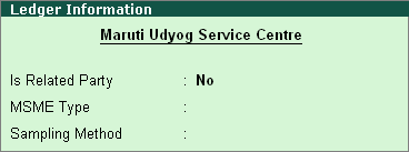

Click on I: Other Info or press Alt+I to view the following details:
Whether this Ledger is identified as Related Party also?
Type of Enterprise if the Ledger is a Micro, Small or Medium Enterprise ?
Details of Sampling Method applied if any.

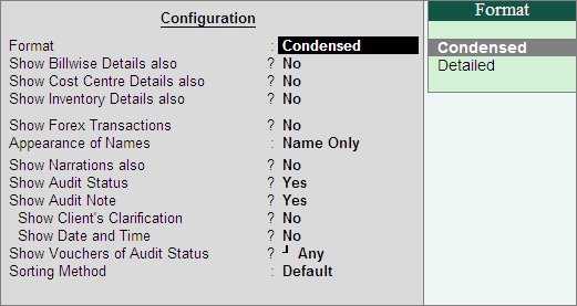

Click on F12: Configure or press on F12 to alter the default display for the above report.
Show Narrations also: Set this option to Yes to display the Narration entered by the Client during the Voucher entry
Show Audit Status: Set this option to Yes to display the Audit Status as selected by the Auditor during the Audit. This option is set to Yes by default.
Show Audit Note: Set this option to Yes to display the Audit Note as entered by the Auditor during the Audit. This option is set to Yes by default.
Show Client's Clarification: Set this option to Yes to display the Clarification Note entered by the Client for the Vouchers marked as Need Clarification by the Auditor.

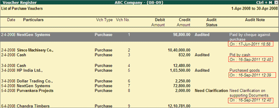

Show Date and Time: Set this option to Yes to view the audit Date & Time.
On enabling Show Date and Time the Ledger Vouchers report appears as shown:
Show Vouchers of Audit Status: Select the required Audit Status for Vouchers (from Altered, Audited, Clarified, Need Clarification, Unaudited, Under Observation, On Hold and Any) to filter and display the Vouchers for the selected Audit Status.
