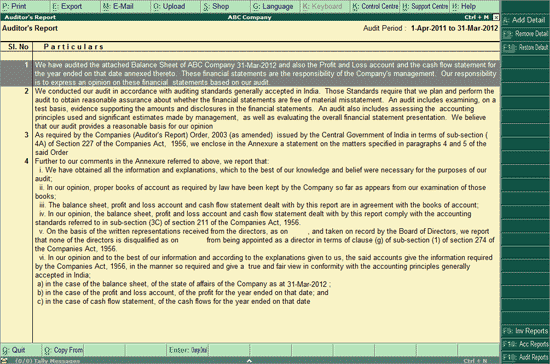

An Auditor’s Report is a statement consisting of the auditor’s opinion on the fairness of a legal entity’s financial statements. Tally.ERP 9’s Auditor’s Report comes with pre-filled but editable statements that are required to be made by auditors.

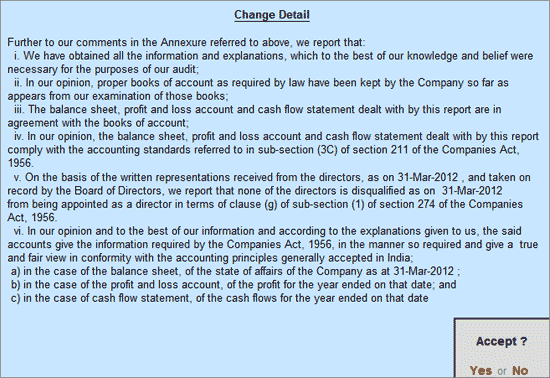

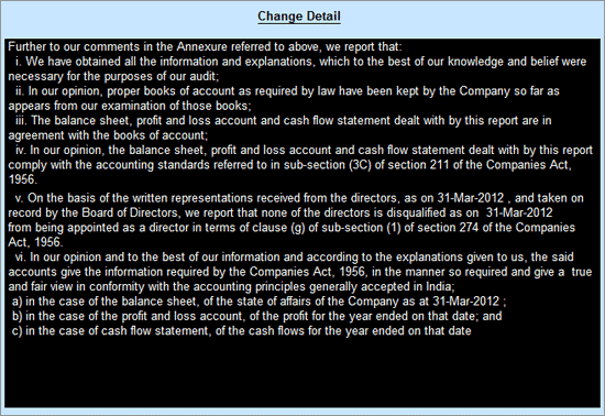

To edit the statements, press Enter.
The Change Detail screen appears as shown below:
Press Enter or click Yes to Accept the changes made.

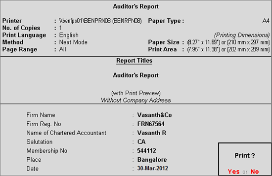

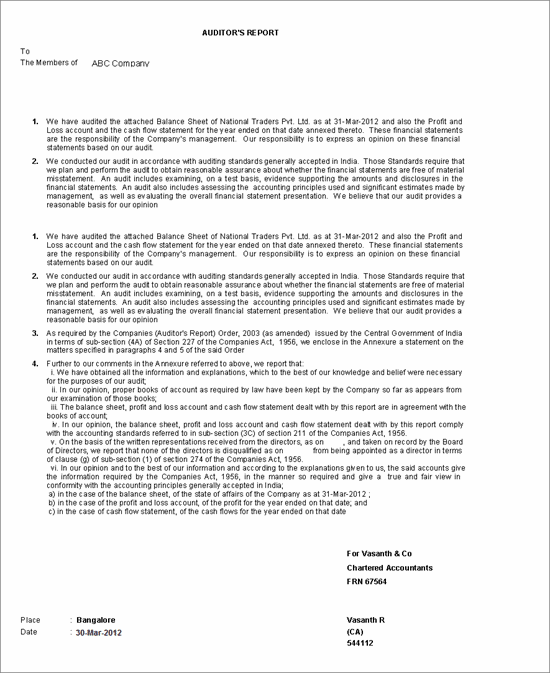

To print Auditor’s Report
Click P: Print or press Alt+P.
The Print Report screen appears as shown below:
To print Firm Name, Name of Chartered Accountant, Salutation, Place, and Date press Backspace.
Fill in the Firm Name, Name of Chartered Accountant, Salutation, Place, and Date.
Press Enter or click Yes to print the report.
Note: Note: For print preview, click on I: With Preview or press Alt+I in the Print Report screen.

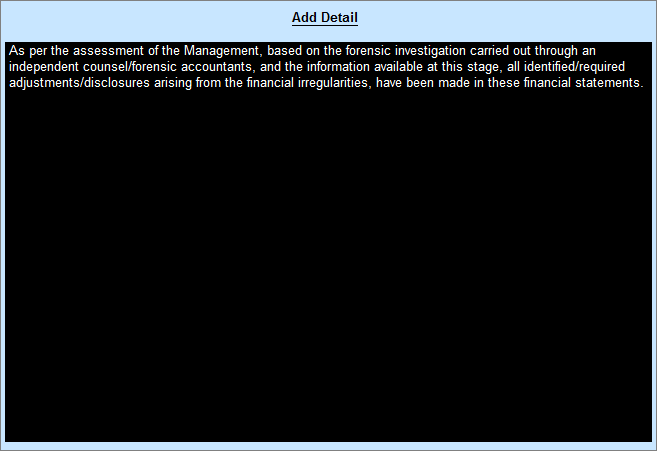

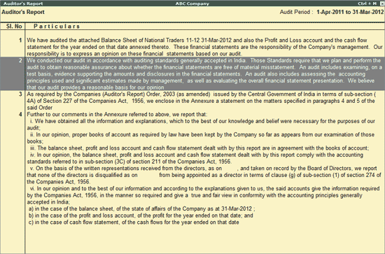

A: Add Detail (Alt+A)
To include any additional statement in the Auditor’s Report. Place the cursor on the statement above which the statement being added has to appear.
Press Alt+A.

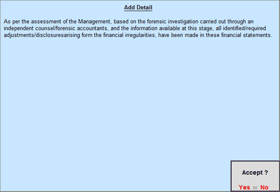

The Add Detail screen appears as shown:
Enter the required details, and press Y or Enter to save the detail added.

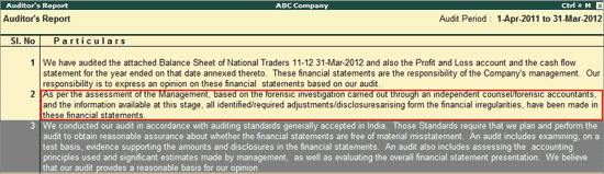

Auditor's Report appears with the detail added above the selected statement:
