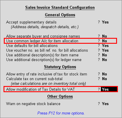

2.     Press F12: Configure.
o      Set the option Use common ledger A/c for item allocation to No.
o      Set the option Allow modification of Tax Details for VAT to Yes.

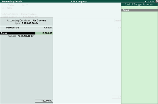

7.     Select the sales ledger in Accounting Details screen.

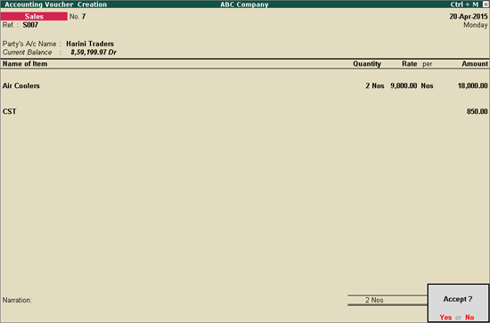

10.  Select CST ledger. The sales invoice appears as shown below:
11.  Press Enter to accept.
