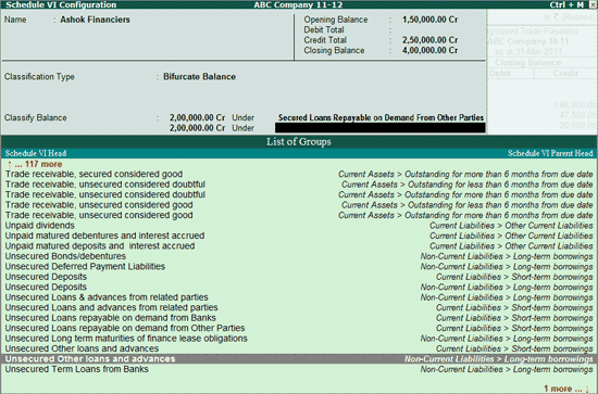

Users can classify Tally Groups/Ledgers under Schedule VI Heads as required, all the while keeping the Balance Sheet and data intact.

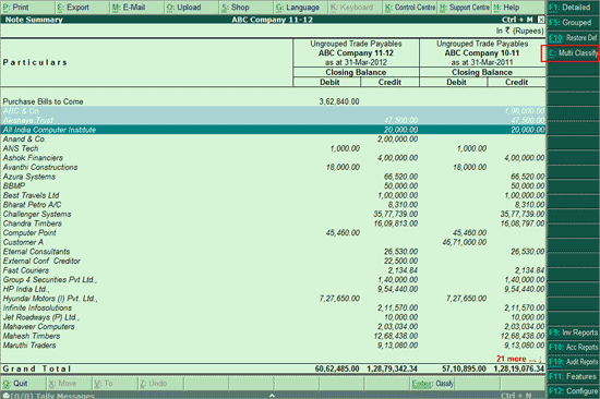

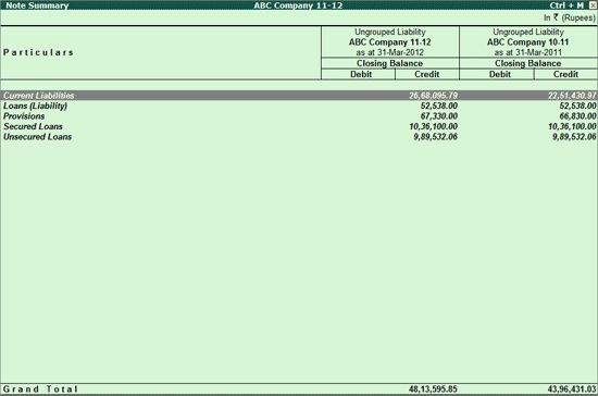

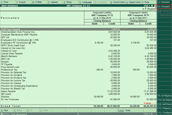

The Note Summary for the selected Schedule VI Head appears as shown below:

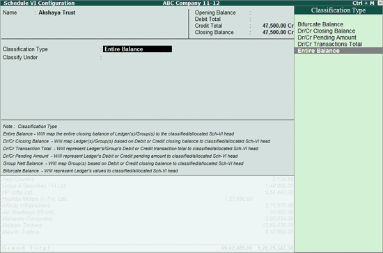

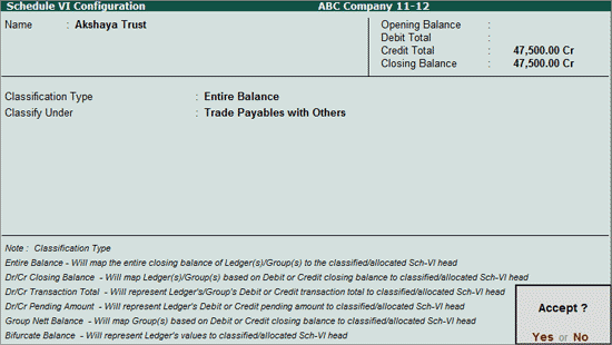

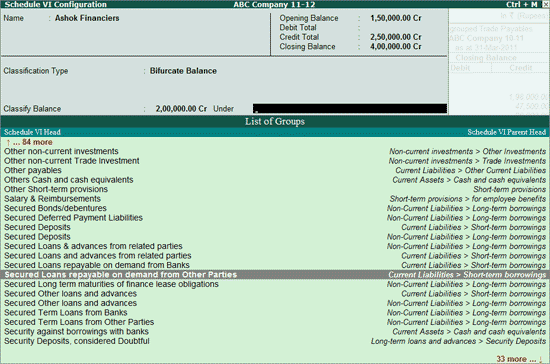

Schedule VI Rule Configuration for Ledgers

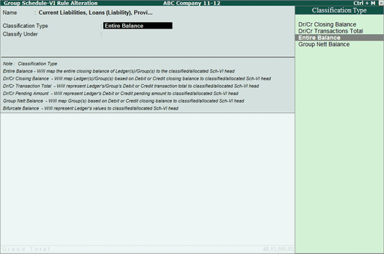

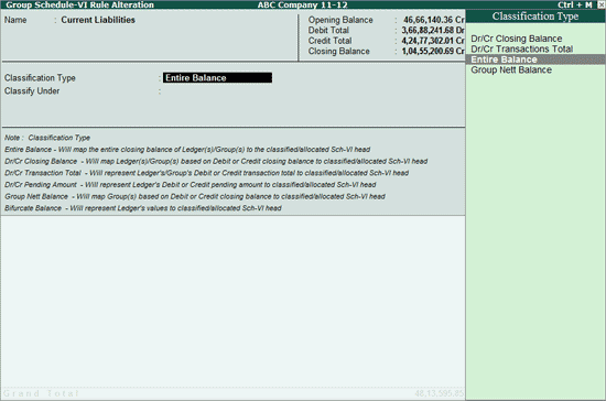

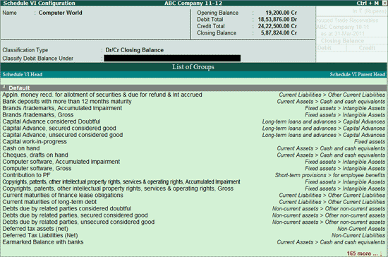

Schedule VI Rule Configuration for Groups

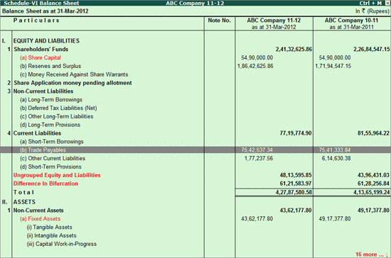

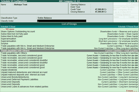

Schedule VI Classification
The procedure to configure Schedule VI Rules for both Ledgers and Groups are the same.

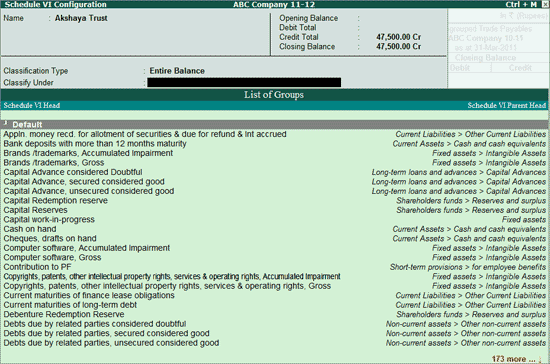

Schedule VI Rule Configuration for Groups/Ledgers can be done based on Classification Type and Schedule VI Groups.

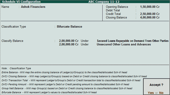

There are 6 ways to classify the balances of Tally Groups/Ledgers under the different Schedule VI Heads:
Entire Balance
Bifurcate Balance
Dr/Cr Closing Balance
Dr/Cr Pending Amount
Dr/Cr Transactions Total
Group Nett Balance
