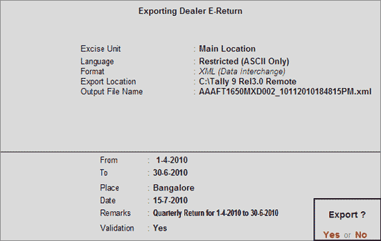

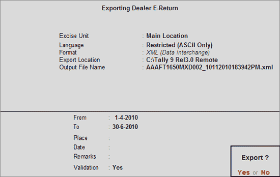

Exporting Dealer - E-Return screen appears as shown:
Press Backspace to provide Return's period, Place, Date of generating e-returns and other details
Excise Unit: As Tally.ERP 9 allows creating and maintaining accounts of multiple units in a single company and allows to generate Excise Unit-wise e-returns, Excise Unit field is provided to select the Excise unit for which E-Return to be generated. Example: ABC Company.
Language: Language is fixed to Restricted (ASCII Only) and the application will not allow to move the cursor to change the language
Format: Format is fixed to XML (Data Interchange). Currently, the ACES application supports the uploading of E-Returns generated in XML format from computerised systems. Hence, the XML (Data Interchange) is defaulted and application does not allow to change the export format.
Export Location: By default, it displays the path where Tally.ERP 9 is installed. In Export Location field enter the details of the path to where the XML file to be exported.
Output File Name: Tally.ERP 9 by default displays the Out File Name in the Format as specified under E-Return Requirements.
The E-Return Requirement has clearly indicated that the E-Return File Format should - 15 Digit ECC Number_ Month Date Year Hour Minutes Seconds AM/PM.xml
Example: ACCEP4589SXD001_10012010162655PM.xml
Note: Tally.ERP 9 allows the user to change the Output File Name while generating the e-return in XML format.
But to upload the E-Returns, assessee has to follow the file name structure as specified under E-Returns Requirement. If the File name structure is different then, the ACES application will not allow the Assessee to upload the Returns.
From: In this field enter the period (1-4-2010) from where the return to be generated.
To: In this field enter the till (30-6-2010) date to generate the return
Place: In this field enter the place of generating the return
Date: In this field enter the Date on which e-Return is generated
Remarks: In this field enter the details as Quarterly Return for 1-4-2010 to 30-6-2010
Note: From and To period, Place, Date and Remarks are Mandatory fields. If the Assessee generates the returns without or incomplete details, the e-return generated will show the errors for the missing details.
Validation: This field will be displayed in Exporting Dealer E-Return screen only when the HSN code defined in Tariff Classification, ECC Number entered in Party Led ger are not correct and the Stock Items without valid Reporting UOM.

The completed Exporting Dealer E-Return screen is displayed as shown
Press Enter to export the Return.
