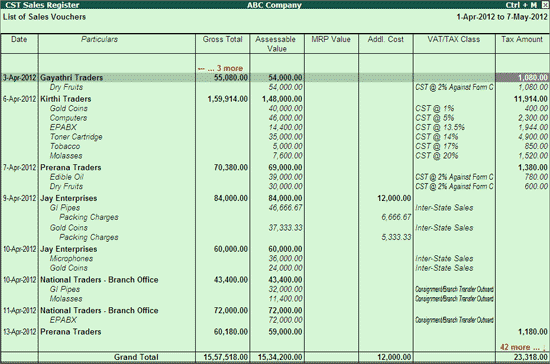

Go to Gateway of Tally > Display > Statutory Reports > CST > CST Register > CST Sales
Press F12: Configure. By default, the fields - Show Voucher Number and Show Quantity Details will be set to Yes. To view the Voucher Reference number, CST number, rate and item value set the options as shown below:

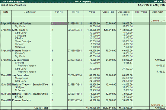

In the CST Sales Register screen, press F1: Detailed button (Alt+F1) to display the inventory details and VAT/Tax classifications. The CST Sales Register displays as shown:
Scroll horizontally to view the columnar details.
The columnar details of CST Sales register are explained below:
Date: The invoice date is captured here
Particulars: The name of the party and the stock items invoiced is captured here.
Voucher Ref: The reference number entered in Ref field of sales invoice is captured here.
Vch No.: The voucher number of the Sales invoice/voucher is captured here.
TIN No.: The TIN/Sales Tax number defined in the selected party ledger master is captured here.
CST No.: The CST Number defined in the selected party ledger master is captured here.
Quantity: The quantity of stock item invoiced is captured here.
Rate: The rate of the stock item invoiced is captured here.
Value: The value of stock items Sales i.e., Quantity x Rate is captured here. The tax amount and value of additional ledgers is not considered here.
Gross Total: The total invoice value is captured here.
Assessable Value: The assessable value excluding tax is captured here.
MRP Value: The MRP Value is captured here.
Addl. Cost: The value of apportioned additional expenses/discount received is captured here.
VAT/Tax Class: The VAT/Tax classifications selected while invoicing for each stock item is captured here.
Tax Amount: The CST collected on interstate sales is captured here.
