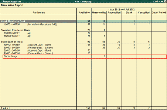

The Cheque Register report screen will appear as shown:

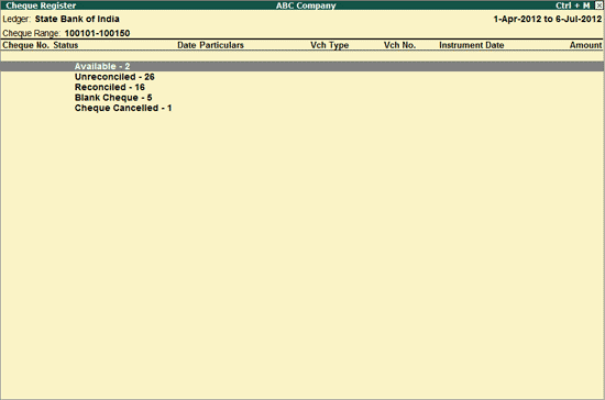

The first level of the Cheque Register displays all the Banks and gives the number of total cheques which are Available, Unreconciled, Reconciled, Blank and Cancelled.
Users can drill down from any of the fields.
To view the break-up of the statics based on the Cheque Ranges, press F1: Detailed.
The period of the report can be changed using the F2: Period option.
Using F5: Reconcile button, users can go to the Bank Reconciliation screen for a particular bank.

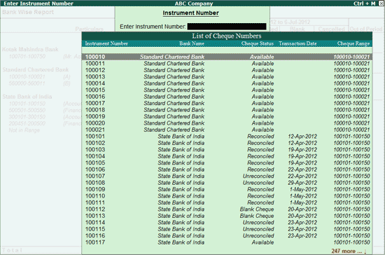

To search for a particular cheque’s details, press S: Quick Search. Part of the cheque number can be used to search for a cheque. The search results will have all the cheques which have the search string as shown:
To view all the Cheques that belong to a particular status like Available, Blank Cheque, Cheque Cancelled, Reconciled and Unreconciled, irrespective of banks and Cheque Ranges, users can press Ctrl+S (Show All) and select the Status.

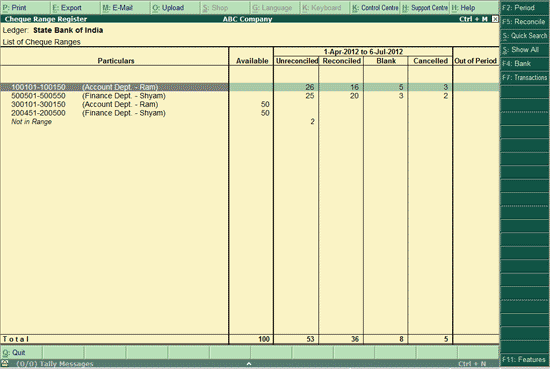

When Enter is pressed from a Bank, Cheque Register shows the statistics of all the Cheque Ranges of that bank, as shown:
When the cursor is on a Cheque Range, to reconcile the cheques that are used in that range, press F5 or click on F5: Reconcile. Tally.ERP 9 will list out all the transactions corresponding to the Cheques in that range that have to be reconciled.
S: Quick Search option can be used in this screen as well.
Ctrl+S (Show All) option can be used to view all the cheque numbers of a particular status, irrespective of the Cheque Ranges, for the selected bank.

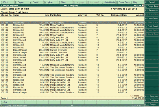

To view all the transaction details of all the Cheques in the Bank press F7 or click on F7: Transactions. All the details of every cheque for that bank will be displayed as shown:
Note: To view all the transactions of all the cheques in a particular range, press Enter from that range.

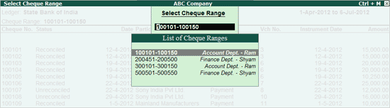

To toggle between the different Cheque Ranges in a bank from the same screen, press Ctrl+C (Cheque Range).

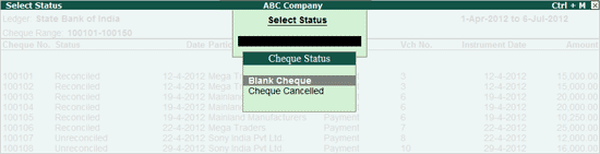

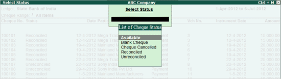

To view all Cheques of a particular status, press F6 or click on F6: Status. A new screen will appear where user can choose among the different statuses of cheques.
To change the status of a cheque, select the Cheque Number and press Alt+A or click A: Alter Status. The status of Available cheques can be updated as Blank or Cancelled. The Status of Cancelled cheques can be changed to Available.
For Available Cheque Numbers, users can create a voucher from this screen itself. Press Alt+C or click on C: Create Voucher to record a transaction for a selected cheque number. The Payment Voucher Creation screen will appear, where you can record the transaction.

For cheques that are already used and are not a part of any cheque range, users can define a Cheque Range in the Bank ledger, and can add these Cheque numbers to the new book (Cheque Range) created using the Alt+R (R: Refresh Range) option.

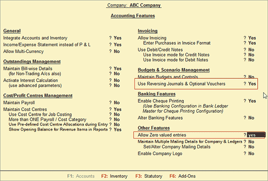

To update a cheque’s status as Blank,
The options Use Reversing Journals & Optional Vouchers and Allow Zero valued entries to Yes in F11: Features (F1: Accounting Features).
Select an Available Cheque Number and press Alt+A or click A: Alter Status.
Select Blank Cheque from Cheque Status as shown:

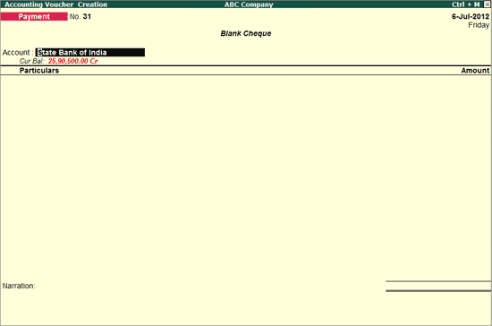

You will be taken to Payment Voucher Creation screen as shown:
The voucher will be marked as Blank Cheque.
User can change Voucher Number and Amount field. No other field is allowed to be altered.
If Amount field is left blank and the voucher is accepted, the status of the cheque in the Cheque Register will be Blank.
Once the value is entered in Amount field, the Blank Cheque tag will disappear. The status of the cheque in the Cheque Register will be Unreconciled.

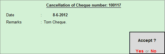

To update a Cheque's Status as Cancelled,
Cancelling a Voucher will automatically change the Status of the Cheque(s) used in that voucher to Cancelled.
In case a new cheque has to issued for a transaction for which the issued cheque cannot be used due to various reasons like - lost in transit, torn cheque etc., the previously used Cheque has to be cancelled. You will have to follow the below procedure:
Go to Voucher Alteration screen of the Cheque which has to be cancelled, and change Cheque number
In Cheque Register, the status of Cheque number which was changed, will be under Available.
Press Alt+A or click on A: Alter Status, and select Cheque Cancelled, give a Date on which the Cheque was cancelled and enter the reason for cancellation in Remarks field.
Accept the screen. The Cheque’s status in the Cheque Register will be Cancelled.

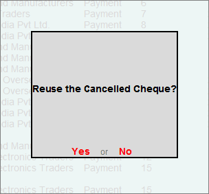

To update a cheque’s status as Available,
Select a Cancelled Cheque Number and press Alt+A or click A: Alter Status.
A message - Reuse the Cancelled Cheque? will appear as shown:
Press Enter or click on Yes to reuse the Cancelled Cheque.
