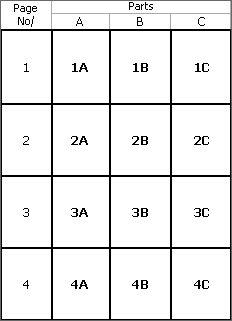

Multi-Part Printing
Multi-Part printing is the concept introduced in Tally.ERP 9 which splits the entire printable into parts when the line does not fit the specified page width. Each part is identified with an alphabet and associated to the respective page number. Each page can have parts commencing with the alphabet A and ending with Z, in case the number of parts for a page are exceeding the alphabet Z, the fresh parts commence with a combination of alphabets AA, AB, AC……AZ, BA, BB, BC…..BZ and so on.

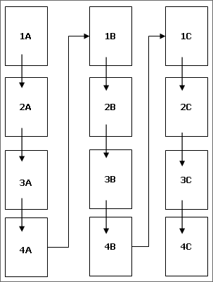

Print Sequence
Printing a report with multiple parts commences by printing all the pages for part A, , i.e., 1A, 2A, 3A, 4A, …….nA, followed by printing all the pages for part B and then prints all pages for part C and so on.  The diagram below depicts the multi-part printing sequence:
