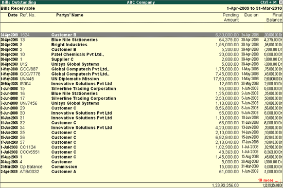

The Bills Receivable screen is displayed as shown:
This report displays all outstanding receivables invoice-by-invoice, till date. This report takes into consideration only those party ledgers for which the option Maintain balances Bill-by-Bill option is enabled.
Date
This is the Effective date of the invoice and not the actual date. Hence, if your invoice date is 15th November but the effective date is 30th November, and then 30th November will be displayed here. Credit period is calculated from the effective date.
Reference Number
This is the bill reference number entered in the Bill-wise Details screen.
Party's Name
The party ledger name appears in this field.
Pending Amount
This is the outstanding balance on a particular invoice. To see the breakup, press Shift + Enter.
To view the complete breakup of all the bills, press the F1: Detailed button. This view toggles with the button F1: Condensed.
Due On
This is the due date of the bill (with reference to the Effective date) specified during voucher entry.

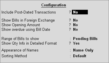

The F12: Configuration screen for Bills Outstanding report is displayed as shown.
For complete information on F12: Configuration, click here.
