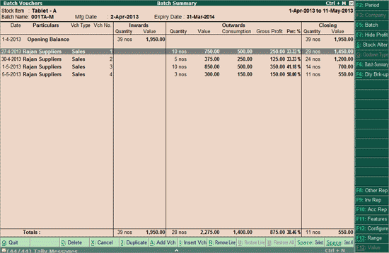

Batch Vouchers is a list of all vouchers for a particular Stock Item of the same batch for the given period. The report comprises of both inwards and outwards transactions along with Quantity, Rate and Closing Value details for the selected batch.
The Batch Vouchers report will be available when Maintain Batch-wise Details is enabled in F11: Inventory Features (F2).
To enable Batch-wise Details refer Using Batch-wise details.
To view Batch Vouchers report,

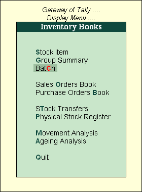

Go to Gateway of Tally > Display > Inventory Books
Select the Batch menu.
Select the required stock item and select the Batch from the List of Batches.
The Batch Vouchers report will be displayed as below:
Note : The Batch Vouchers report will be available when Maintain Batch-wise Details is enabled in F11: Inventory Features (F2).

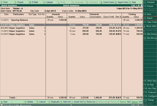

Alternatively, you can also display Batch Vouchers Report from the Stock Vouchers screen, as explained below :
Go to Gateway of Tally > Stock Summary
Press Enter and drill down to Stock Voucher screen.
Press F5: Batch and select the required Batch for the selected Item as shown:
The Batch Vouchers Report will appear as shown below:
To view Profitability and Consumption details, press F7: Show Profit button from the above screen. The report will display quantity and value of the opening stock, inward goods, outward goods, closing stock and the value of consumption (using the cost method).

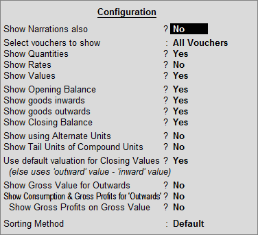

Show Narrations also
By default this option will be set to ‘No’. Set ‘Yes’ to view the report with narration for all transactions.
Select vouchers to show
By default All Vouchers will be displayed for the Batches selected. If you like to view only ‘Inwards’ or only ‘Outwards’ entries then the same can be selected from vouchers to show.
The Configuration settings Show Quantities, Show Rates, Show Values, are self explanatory.
Show goods inwards
By default this option will be set to Yes. It will display the all Inward details, like inward quantities, inward rate and inward value.
Show goods outwards
By default this option will be set to Yes. It will display the all Outward details, like outward quantities, outward rate and outward value.
Show Closing Balance
By default this option will be set to Yes. It will display closing quantity, rate and value.
Closing Quantity = Opening quantity + Inward Quantity – Outward Quantity
Closing Rate = Closing Value / Closing Quantity
Closing Value = The Closing Stock Value will be based on the Costing Method adopted for each item.
Show using Alternate Units
By default this option will be set to No. By setting this option to Yes, it will display the Alternate Units information, if stock item is created with the Alternate units
Show Tail Units of Compound Units
By default this option will be set to No. By setting this option to Yes, it will display the Compound Units information, if stock item is created with the Compound units.
Use default valuation for Closing Values?
(else uses ‘outwards’ value – ‘Inward’ values)
By default this option will be set to Yes. By setting this option to No, it will display Closing value = Opening value + Inward Value – Outward Value. Transaction value is only for reporting purpose to compare with default valuation. It will not show it in Profit and Loss account.
Show Gross Value for Outwards
Gross value of Outwards refers to that value which is inclusive of the values of VAT/any other allowed ledger under accounting allocation screen of the stock item. By default this option will be set to ‘No’, when it is set ‘Yes’, it will display the gross value of the outwards.
Show Consumption & Gross Profit for ‘Outwards’?
By default this option will be set to No. Pressing F7: Show Profit in the button bar or enabling this option in F12: Configuration will display gross profit / loss of batch selected.
For detailed explanation on each column click here.
Show Gross Profits on Gross Value
By default this option will be set to ‘No’. When this option is set to Yes, the gross profit will be calculated on the Gross Value which is inclusive of the values of VAT/any other allowed ledger under accounting allocation screen of the stock item.
Sorting Method
This will help the user to sort the report Alphabetical wise increasing / decreasing.

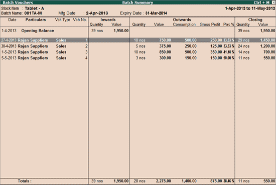

Explanation for each column is displayed as below:
Columns |
Details |
Inwards |
All the goods Inward item are captured here. |
Outwards |
All the goods Outward item are captured here. |
Consumption |
Cost of Goods Sold of respective outward entry. Cost of Goods Sold derived as per valuation method specified in item master. |
Gross Profit |
Outward Value – Cost of Goods Sold. |
Perc % |
Gross Profit / Outward Value x 100 |
Closing Quantity |
Outward Quantity – Inward Quantity |
Closing Rate |
Closing Value / Closing Rate |
Closing Value |
Stock item closing value. This value is derived as per valuation method specified in item master. If Transaction value is enabled in F12 then Closing value = Opening value + Inward Value – Outward Value. This transaction value is only for reporting purpose to compare with default valuation. It will not show it in Profit and Loss account. |
Total Inward |
Opening + Total Inward entries |
Total Outward |
Total Outward entries |
Total Consumption |
Total Inward Value – Total Closing Value |
Total Gross profit |
Total consumption – Total Outward Value |
Total Closing |
Closing value derived as per valuation method specified in item master. If Transaction value is enabled in F12 then Closing value = Opening value + Inward Value – Outward Value. |
