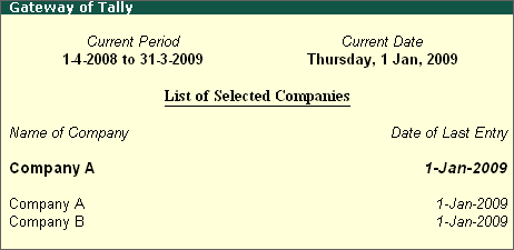

Tally.ERP 9 now displays two company names in the Gateway of Tally.
Note: The Company which is in bold, is the active company. Here, Company A is the active company.

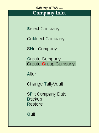

Use Alt+F3 to get the company info Menu in which there is an additional option Create Group Company (this is available only when two or more companies are loaded)

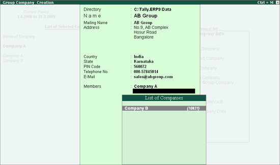

Press Enter on Create Group Company. The Group Company Creation screen is displayed.
All the loaded companies are displayed under List of companies. Select the member companies from the List of companies and accept to Create the Group Company.

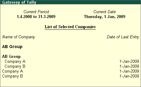

At the Gateway of Tally, Tally.ERP 9 displays AB Group company and the member companies. You can close the member companies by pressing Alt+F1, so that only the Group Company is displayed in the Gateway of Tally.
